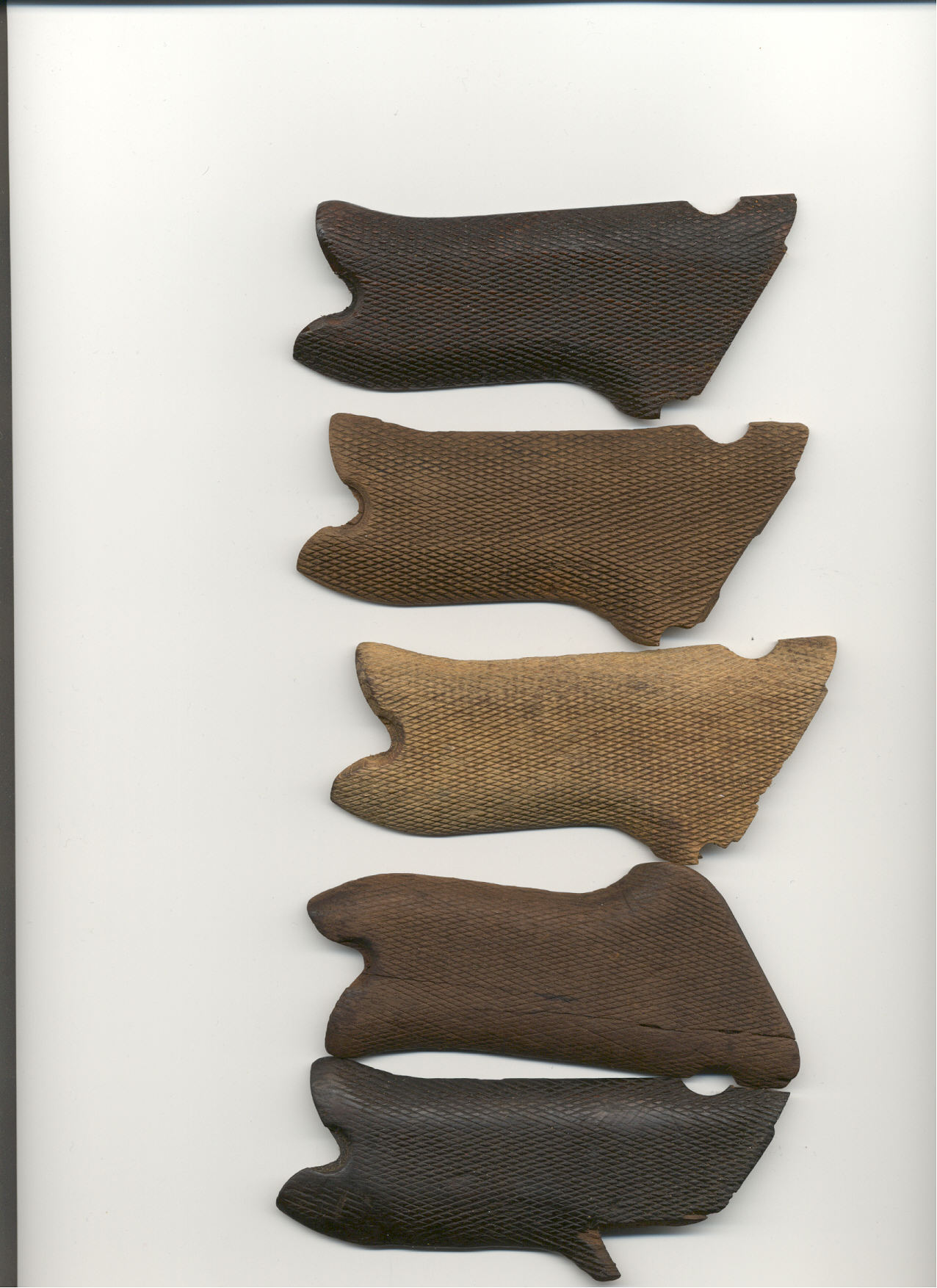

Top grip [uncleaned]. The second and third grips looked like this before all night soak in paste. They have not had any oil or stain added after soak and dry. Grips 4 and 5 from top were junk, black and full of crud. Number 4 was soaked in Easy Off oven cleaner for 2 hours as mentioned in text.

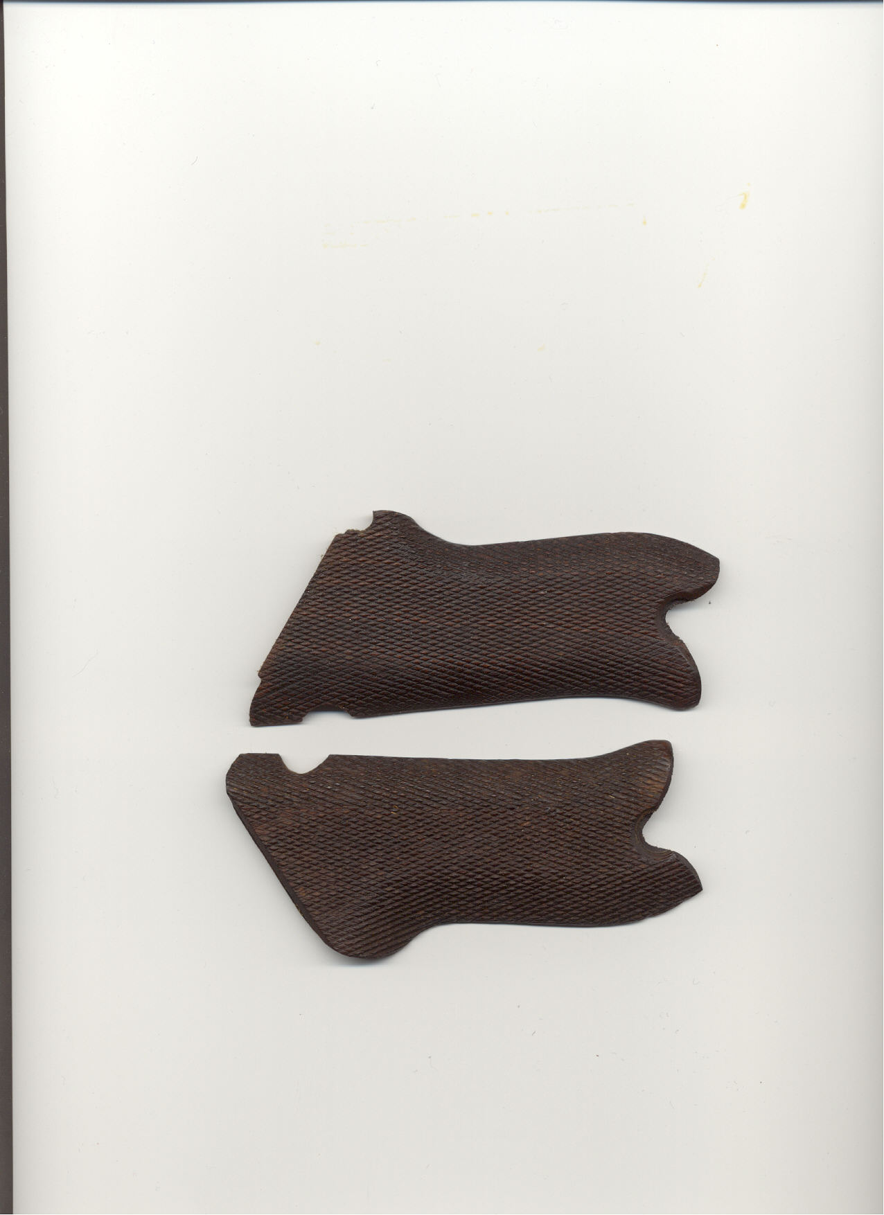

Grips before soak in paste.

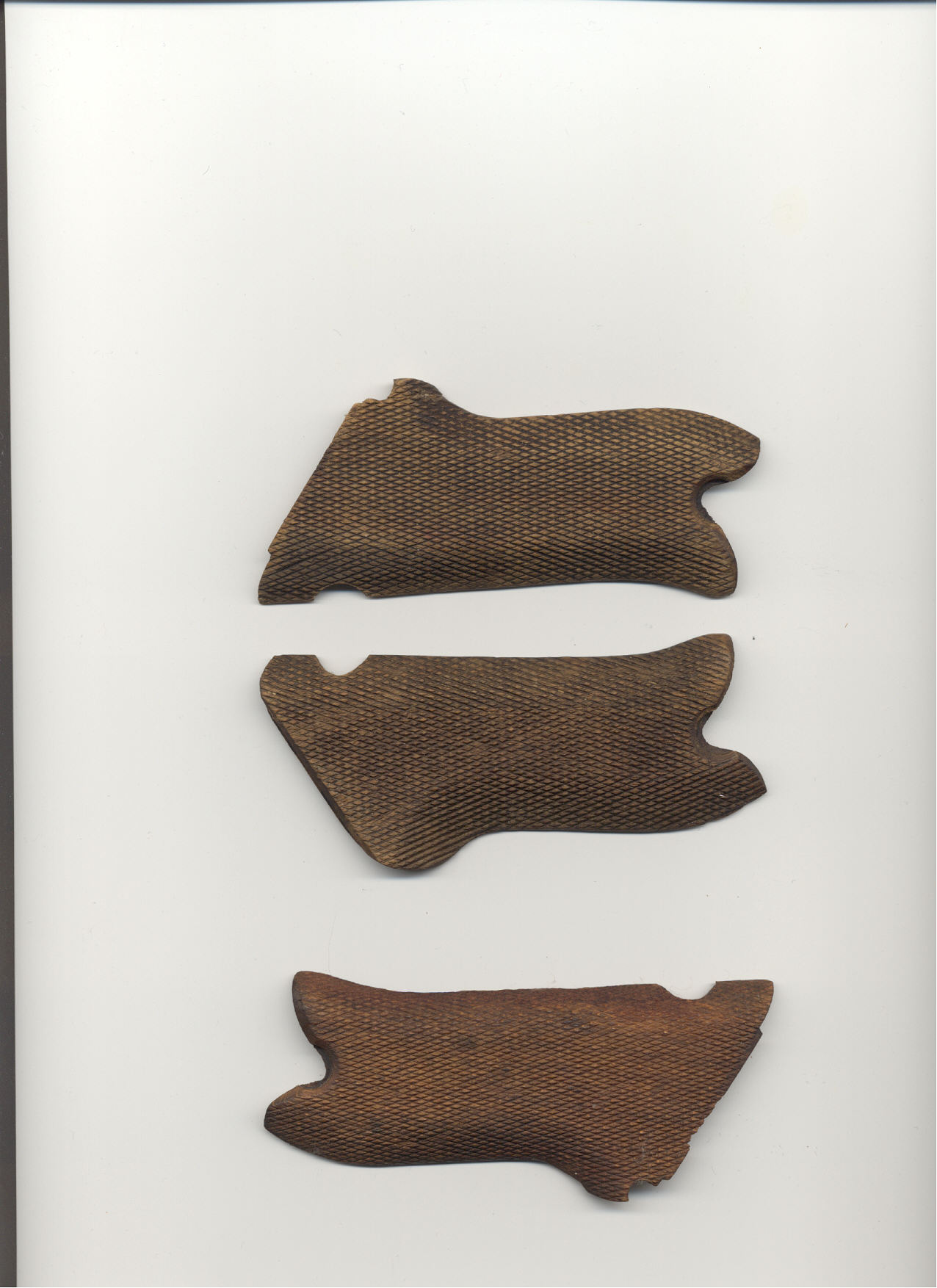

Same pair of grips after 4 hour soak in paste and allowed to dry. No stain or oil added. The single grip at bottom is the same light color grip shown in the first picture that ended up light color after soak. This picture shows it after one application of Pilkington red brown rubbing oil[applied with a Qtip]. All of the grips shown came from import Lugers. The grips looked somewhat darker before cleaning and a bit lighter after than the scans indicate.
