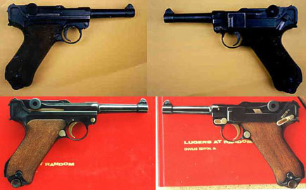

Q: | How do I clean up my old Luger grips, they are really dirty? |
A: | You never know what you are going to get with Luger grip cleanup. IF they are completely
oil soaked throughout, you are WASTING your time! IF, like the ones you see in the picture they are covered with dry surface grime and oil from handling 80+ years, these are the candidates you are looking for! This is a wide spread practice in the Luger community and freely given to all. Take the grips off the gun, does the back seem MUCH lighter color and dry (no oil soaked through) IF yes continue. Be VERY careful removing them especially around the safety area, because if they stick to the gun you may get a small chip come off. OF course we are talking wood grips here! Make up a solution of very warm water and MURPHY's OIL SOAP in a small bowl. Fill the bowl about 3/4 full with water and put about a 1/2 capful of the soap and mix well with a clean soft nylon bristle tooth brush. Needless to say, this toothbrush is never to be used again for personal hygiene! AGGRESSIVELY scrub the grips in the solution, you can put them right into the solution without worry! The solution should start to get really crappy looking as the dirt is stripped off. Change the solution every 5 minutes or so until you get all the grime off (it took about 6 changes of solution to do the grips you see in the picture below) ![]() Once you have stripped all the crap off those grips you need to discard all the solution and water rinse them clean. Then blot with a paper towel to get the water off them as much as possible. Allow to air dry. This can take as little as 6 hours in arid climates or more in humid climates. I usually let mine dry overnight! When dry they will APPEAR GRAY, MOTTLED AND CRAPPY LOOKING... DONT FREAK OUT! THIS IS NORMAL!!! With a SOFT brush, apply a very thin coating of BOILED LINSEED OIL (Not plain, it MUST be BOILED) to the grips front, side and back. Let the grip stand for 5 minutes (this allows the wood to soak up the oil to some degree), then paper towel (or toliet paper) blot excess oil from checkering and grooving (very important to keep from getting excess deposits of the oil crystalizing in the checkering) Let air dry the same amount of time as the cleaning bath rinse. Reinstall, they will look lighter color and fit better and tighter. Old soaked grips dont clean up this way, but surface grip from handling and dirt do! Good Luck and let me know how they turn out! Ted |

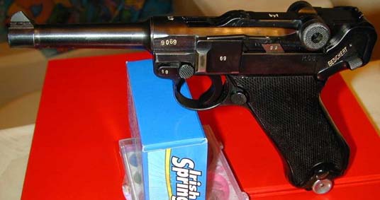

Q: | What is a "Black Widow" Luger? |
A: |
Typically a 41 or a 42 dated chamber Mauser, toggle coded "byf" with black plastic grips (on about 20% of them). This was simply a marketing tactic employed, and the phase was coined by Ralph Shattuck (he tells me). It really worked. These guns have a black salt blued finish, black grips, and all blued (black color) small parts (trigger, safety lever and take down lever). Some of the 1940 vintage (a very few), and 41/42 Lugers had them also, but primiarly the "byf" with black grips are a "Black Widow". This was an American invention, and had no German basis at all! German collectors say "Huh?" sometimes, when you mention the term! Shown below is an example of a "Black Widow". Thor
